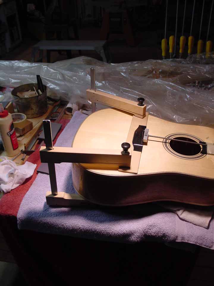

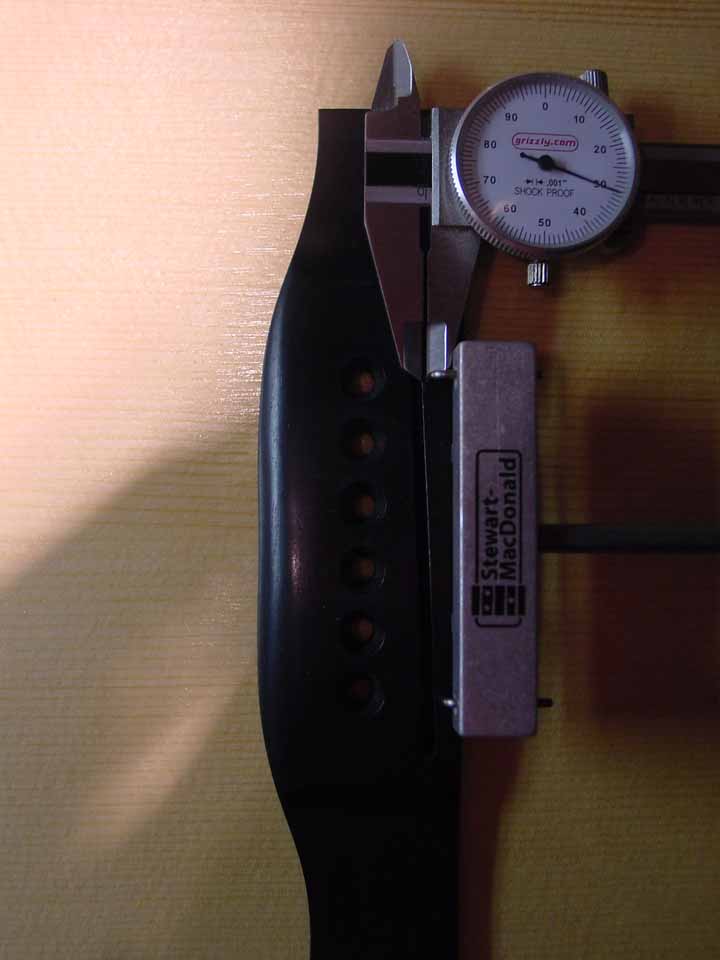

The pictures below show how I set it up with the “Saddlematic” I purchased from StewMac.

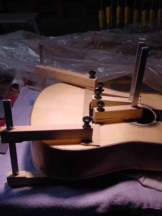

One of the pictures shows, what I thought, was a pretty good idea. I made (for the lack of a
better word) a bridge holder. Once I had the bridge in the perfect position, I clamped the bridge
holder very lightly to the body of the guitar. I was then able to remove the “Saddlematic”, and
glue up, and clamp the bridge. It should have worked perfectly, but, some how it did move
somewhere along the procedure. Maybe, its nothing to worry about!
Anyway, before I go any further, I thought, I would put it before the board of well experienced
OLF guitar builders, and see what you all think about it.

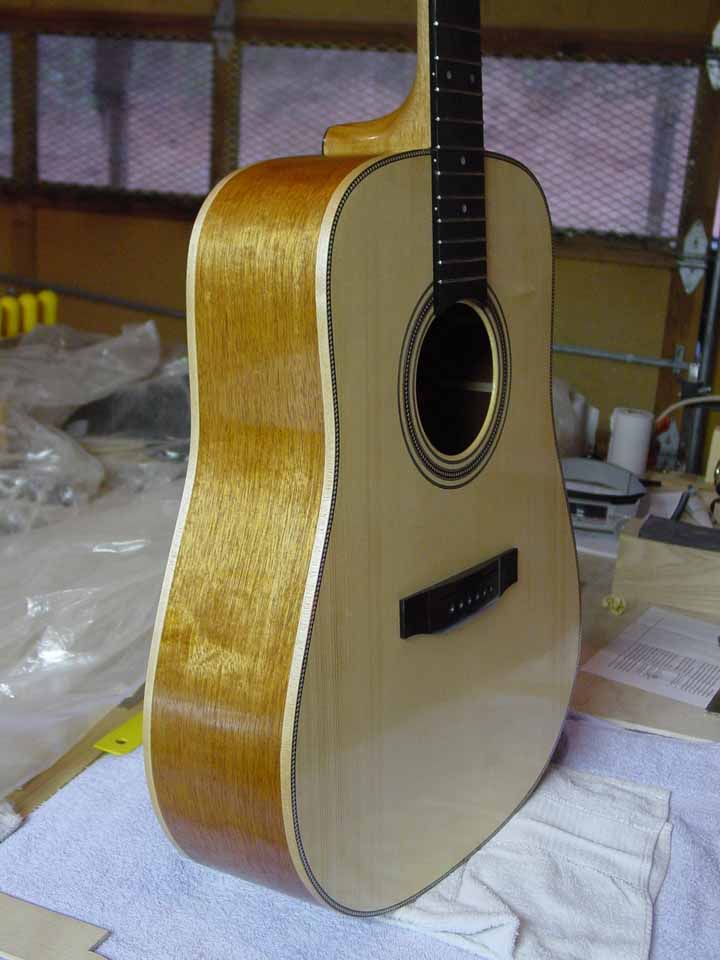

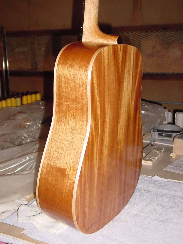

Oh yeah, the last two pictures show the final polished True-Oil finish on the body.

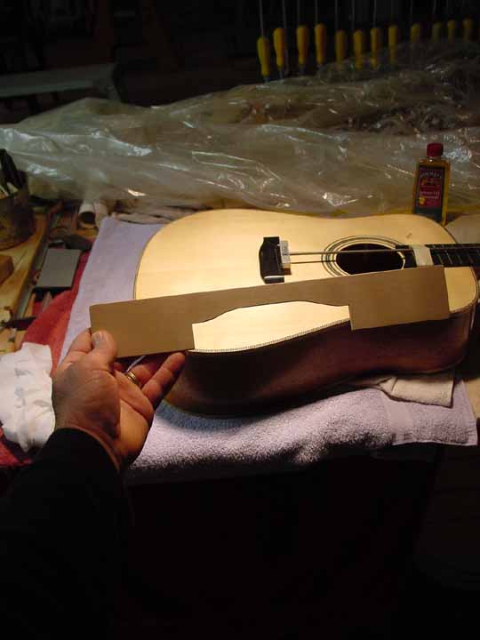

The first thing I did, was check the bridge placement
the following is a re-enactment from yesterday
Here's the polished True-Oil Finish on the body.

               First of all , I really like that true oil finish . A lot of finishes you see look like the guitar has been dipped in plastic .
Although your bridge jig looks good , I wouldn't trust it again as it has proven it can let you down . A better method is to insert removable pins through the saddle slot . That way, it can't move , and it's simple

Something that you will want to watch out for (a small criticism if you don't mind) is never to clamp to the body on the inside like this.
It doesn't take much pressure to crack that back or top and clamping like this is a good way to crack that new guitar of yours. If you have to clamp to the body, make sure that the clamps are near the edge where the liners and the side are. There is more strength there than in the area you've clamped to above.
Like Craig mentioned, you want to place the bridge than use some sort of locater pin either through the saddle slot or two of the bridge pin holes so that the bridge won't move when you've clamped it down.

try first. I should say, that I was aware of the cam clamp pull, and, I made the allowance for that
every time I did the final clamping. The bridge holder was cut so close to the size of the bridge,
that there was zero play when the bridge was placed in the notch of the bridge holder.
And, I did not remove the “Saddlematic” until I was absolutely sure that the bridge holder was stable, and
that the bridge was snuggly in place. That’s what had me a little stumped.

I would like to say though, that the pressure applied by the cam clamps to the top and back of the guitar
was no more than what could be considered, a firm grasp with your thumb and middle finger.
However, in the future, I could easily do it differently by using masking tape.

Alain, interesting that you should bring that up! I was thinking about this very same thing
yesterday afternoon. I should mention the setup of the “Saddlematic” by StewMac. They give a
compensation of 5/32" for the “Bass E” string, and 1/16" for the “Treble E” string.
These measurements are taken from the side of the block furthest from the 12th fret, and measured to the
pins that are secured in the block. Then you position the bridge, so that the pins are touching the
inside of the slot of the bridge closest to the sound hole. If you copy paste the following link, it
shows in detail how this is done. The question is, did StewMac consider the center of the saddle
when they configured the compensation?
http://www.stewmac.com/shop/Tools/Special_tools_for:_Bridges /1/Saddlematic/Instructions/I-4462.html#details

I got to thinking about what I’d said in my last post. So, I went back to read the instructions again
for the StewMac “Saddlematic”. Turns out StewMac did consider the center of the saddle when
configuring the compensation.

[QUOTE=robertandsons] The question is, did StewMac consider the center of the saddle
Robert[/QUOTE]
Lets see:
0.156 and 0.062 make for 0.109 at the front of the saddel in the middle (between D and G strings).
The saddle is 3/32 thick = 0.09375"
The center is at 0.0469"
The compensation at the center is then 0.109+0.0469= 0.156"
Cumpiano recommends 0.15" and this is what I do also.
Your bridge is off by 0.03"
I would say you are OK but your saddel top will be like this   D instead of this O

[QUOTE=BarryDaniels] One thing that has not been mentioned is that when the bridge shifted, it likely had one edge that lifted up over your finish resulting in less than an optimal fit of the bottom of the bridge to the top where you scraped off the finish. If your finish has any thickness to speak off, then your bridge may not be well glued to the top now. [/QUOTE]
Barry brings up a good point. However, your Tru-oil finish is probably whisper thin. If you didn't scrape down into the spruce, but only removed the finish, that couple of mils of finish thickness shouldn't have any effect on the glue joint. Lots of builders scrape (or rout) off the finish a smidge inward from the edge of the bridge outline and glue the bridge on overlapping that little bit of finish around the edge. Some rout a very shallow rabbet around the edge of the underside of the bridge, but many don't do this and don't have any problems. Again, if your finish is very thin and you've been careful to remove only finish, not wood, when scraping, the glue joint should be fine.
